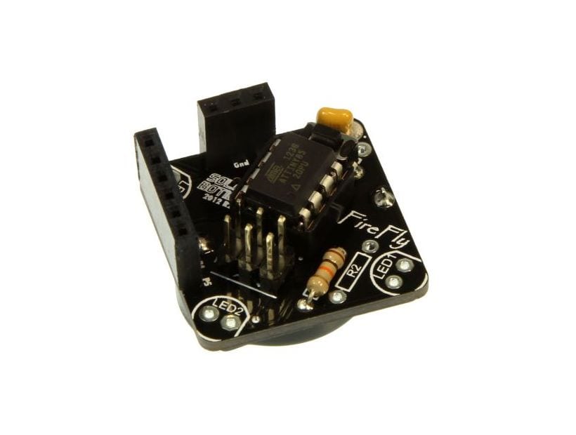

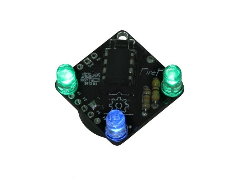

This coin-cell powered microcontroller runs three LEDs through button selectable light blinking sequences with smooth transitions. Use it to teach soldering, have a late night blinky party, or hack into your own creation.
How often do you get a kit where the battery is included? This super small microcontroller is a ready to go ATtiny85 application board that is a smoothly routed, small form factor, through-hole soldering kit. Don’t know how to solder? No worries, this is a great place to start; we have a quick soldering guide in the manual to walk you through the soldering process as long as you have the tools to do it. The kit includes everything, even the battery, to make your own blinky LED project!
We are now on version 2 of SB-FireFly and it is now Digispark (the wildly successful kickstarter project) layout compatible, so you can add Digispark shields onto it. We walk you through building it into this configuration in our newly revised manual (under the Documentation tab). If you don’t have that much of a desire to hack the board feel free to just build the SB-FireFly as it was originally intended, all the instructions are still there. With version 2 we’ve also updated the code to include a new “Rainbow” mode, perfect for RGB LEDs (like in the Northern Lights Bundle) and it now also has the ability to remember the last mode you set if you ever power it down! If you have the previous version of the FireFly not to worry as the code is backward compatible, and located under the Documentation tab.
It has tons of potential, including wearables, – place the it on your clothes then from the other side, apply a magnet to the back of the battery area and you’ll have a SB-FireFly badge! It can also be placed onto a small key ring for a blinky keychain or lanyard, or thread a small string through it for a necklace.
The SB-FireFly features an Arduino-accommodating ATtiny85 microcontroller, so with a minor adjustment (thanks to those smart MIT people) to your Arduino programming IDE, you can reprogram it to suit your whim (check out the instructions in our manual). It also is a handy development/application board to make practical use of this small microcontroller. If you wanted to use AVR studio with a avr programmer by all means you can go that route as well.
The board also has a cleverly hidden 3-pin expansion port usable for project enhancement!
Here are the modes the SB-FireFly comes pre-programmed with (toggled via the button):
Firefly Modes: | Press1 | Press2 | Press3 | Press4 |
Blink All | Slow | Regular | Fast | Sleep |
Metronome | Slow | Regular | Fast | Sleep |
Disco | Slow | Regular | Fast | Sleep |
Fading Eyes | Slow | Regular | Fast | Sleep |
Firefly | Slow | Regular | Fast | Sleep |
Rainbow | Slow | Regular | Fast | Sleep |

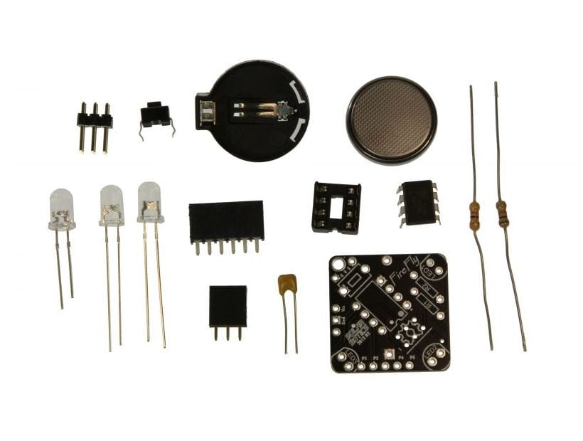

The Kit includes:
- 2 – Green LEDs
- 1 – Blue LED
- 1 – 10Kohm resistor
- 1 – 47ohm resistor
- 1 – Push button
- 1 – 2032 coincell battery
- 1 – Coincell battery holder
- 1 – ATtiny85
- 1 – SB-FireFly PCB
- 1 – 3×2 male ISP programming header
- 1 – 8-pin DIP carrier
- 1 – 3-pin Female Header
- 1 – 6-pin Female Header
- 1 – 0.1uF Capacitor
