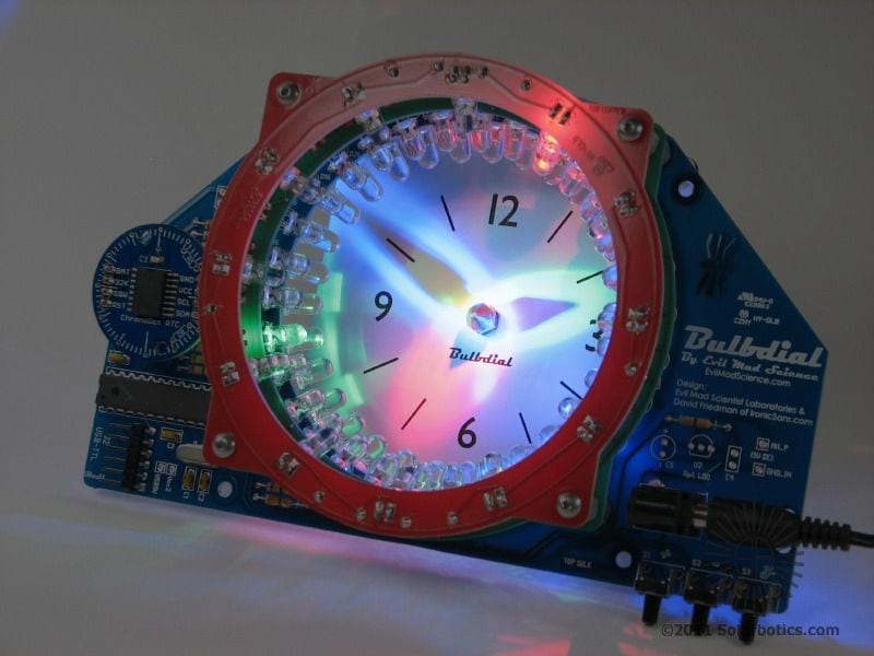

The Bulbdial Clock kit is based on an original design concept from IronicSans.com and developed at Evil Mad Scientist Laboratories. It works like an indoor sundial, but with three shadows of different length. You tell the time just like you do on a normal clock, by reading the positions of the hour, minute, and second hands.
The basic Bulbdial clock kit comes complete with three custom circuit boards, 72 ultra-bright LEDs, pre-programmed ATmega168 microcontroller with Arduino bootloader, tactile button switches, aluminum standoffs, 20 ppm quartz crystal, custom clock face, gnomon spike, universal-input plug-in power supply, stainless mounting hardware, plus the resistors, capacitors and other little parts needed to build the Bulbdial clock.

The kit comes with 12 red, 30 green, and 30 blue LEDs, marking hours, minutes, and seconds. The colors provide contrast and tend to mix in interesting ways. This is the standard 3-color option. You can instead get one with 72 white LEDs, for simple elegance at the cost of some contrast.

The Bulbdial clock kit is open-source in both hardware and software, and is designed to be user friendly and hacker friendly. The on-board microcontroller is an ATmega168, running a program atop the Arduino bootloader. FTDI USB-TTL and AVR-ISP programming header locations are provided on the circuit board. The circuit board also features alternate mounting hole locations– in case you’re building a different case, and a location for a 5 V regulator. An extended introduction to the project and its design is available here. The schematic diagrams and source code are posted and available for download on that page.
